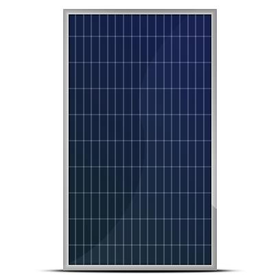

@codyy Zostava 11ks fotovolt. panely 280Wp Canadian solar .(3080Wp)+Solar Inverter 500Vdc 5000W 80A MPPT 48V 220V Off Grid Inverter 5Kva Pure Sine Wave Inverter 60A Battery Charger Zostava 10ks fotovolt. panely 300Wp Canadian solar .(3000Wp)+Solar Inverter 500Vdc 5000W 80A MPPT 48V 220V Off Grid Inverter 5Kva Pure Sine Wave Inverter 60A Battery Charger
@codyy Bluetooth Inverter 3000W 500Vdc PV 230Vac 24Vdc 80A MPPT Solar Charger Support Mobile Monitoring USB LCD Control je vela roznych konbinacii.
@fx123 toto je ten 280Whp panel prva fotka je 330Whp panel
